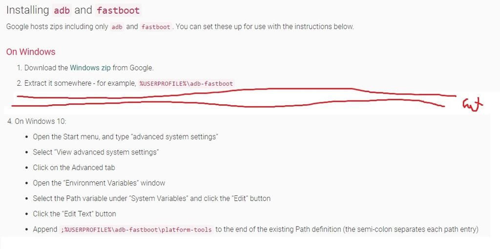

      I need to do this (the last line):
      So get to here:

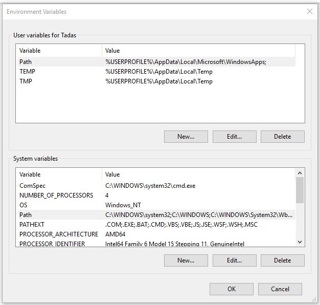

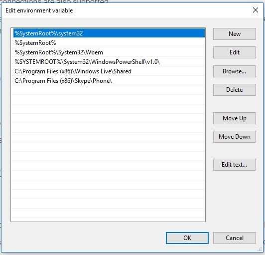

      But when I edit “Path” I get this:
      I expected one continuous line, not multiple entries.
      How do I add the required line to the end of the path?

        Windows 10 has split the path onto multiple lines. Just add it on the next line down and you should be fine. You may need to logout and login again (or restart), just so the path can be reread.

          done that, looks good so far
